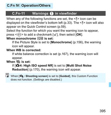

There are a couple of possibilities, but first have a look in your instruction manual (NOT the Basic one!), on P395 - there is a list of events that will cause the display of the exclamation mark.
eos-rebelt7i-800d-im-en.pdf (c-wss.com)

The “!” warning only appears if it is enabled by a Custom Function.
The warning can be for set for Monochrome, White Balance, or Noise Reduction.

You were provided with a link to the manual and a page number to look at.  There are about a half dozen different reasons for the icon to light up.  All of them have to do with changes to the camera settings that you may have made.
