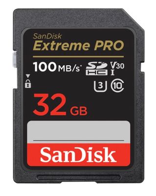

May zi ask about your memory card.  Exactly! What brand, model, and storage capacity is your memory card?
I advise forum members the following:
  • Always and only use full size memory cards. Micro-SD cards that need a plastic adapter are unreliable.
  • Always format your memory card in the the camera prior to first use. And never allow another device to write to the card.
  • Most importantly, only use SDHC memory cards, 32 GB or less.  SDXC cards seem to always have issues.
  • Be careful who and where you buy memory cards. Only buy camera accessories from a reputable, Canon factory authorized retailer. I never use Amazon or similar online marketplaces.
Hope this helps.

Thus is your problem. The memory card. Is it a micro-SD card?  PNY is not a brand that I would use. I use SanDisk Extreme.Pro.
The biggest issue with your card is the oversized storage capacity.  Stick to full size, SDHC cards, 32 GB or less, and your issues will go away. I guarantee it.
PNY is known for micro SD SDXC cards. Use a card reader to copy your photos off your memory card and never use it in the camera again.
