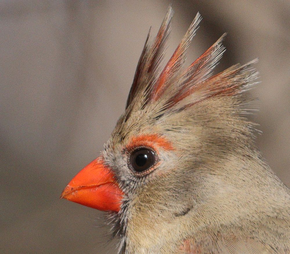

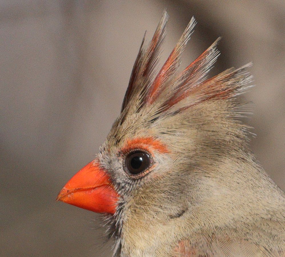

My advice is to always set the camera to save a raw file, then the free Canon DPP software can process it on a computer. Since it is too late for that, here are some less desirable possibilities. (Others have suggested AI upscaling software that one pays to use, but I prefer free software.) The free to download Canon DPP software will also upscale photos, but my example in this post started with a raw file from the camera and not a JPEG. There are many free software programs that will scale an image using various algorithms.
Examples are included in this post. The caption tells how the image was processed. I expect it will be necessary to view the images full screen to see the differences.
GraphicsMagick is free software and has a good algorithm for increasing the number of pixels. 200% works reasonably well when followed by unsharp mask. The default algorithm is described at https://en.wikipedia.org/wiki/Lanczos_algorithm in case you might like a little mathematics. Gimp free software with the GMIC plugin has 3 or 4 up scale algorithms.
The graphics magic command line:
gm convert -verbose IMG_3476c.JPG -resize "200%" -unsharp 0x1 -define 'jpeg:dct-method=float,jpeg:optimize-coding=true' -interlace line  -quality 93 IMG_3476x2.JPG
The DCCI algorithm is described at: https://en.wikipedia.org/wiki/Directional_Cubic_Convolution_Interpolation
crop from original image processed with free to download Canon DPPcrop from original image processed with free to download Canon DPP
crop from same image scaled 200% using graphicsmagick free softwarecrop from same image scaled 200% using graphicsmagick free software
crop from same image using GMIC plugin for gimp free software and DCCI 2x algorithmcrop from same image using GMIC plugin for gimp free software and DCCI 2x algorithm
scaled to 200% using free to download Canon DPP software (I started with raw file and not JPEG)scaled to 200% using free to download Canon DPP software (I started with raw file and not JPEG)
