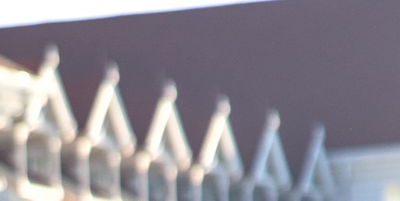

Hello! Quick question! In both the raw and jpeg files from this session, i noticed that the roof of this building was desaturated completely in all of the images as we moved around the property. Not all taken from this spot. You can see the red color the entire roof is supposed to be in the top left corner, the tiny part above the window. That's the accurate color of the entire roof, but for some reason in all the files both raw and jpeg, the roof of the building is completely gray. Earlier in the session we were at a different spot and the color of those very red roofs came through just fine. No settings were changed between the two locations. Any ideas? I would understand it more if it were ALL the reds in the image, but as you can see it picked up a small portion of the actual color of the roof, just not the whole thing. I've never seen this happen before, I'm assuming it has to be something that happened in camera since it recorded this way on both memory cards! Any help is welcome!

Only part that is completely clipped (red,gren and blue) is a small part of the sky right above the tree.
If I lift the shadows I get back the brown colour from this area.
If I do the same with the roof I get some brown colour from the part closest to you. Probably that part gets light reflected.
I would say that it looks like that due to the strong backlight and that the roof is shaded. Let's see what the others say.
BTW, would it look more natural if you darken the roof and the sky? Maybe not as much as I did here below.

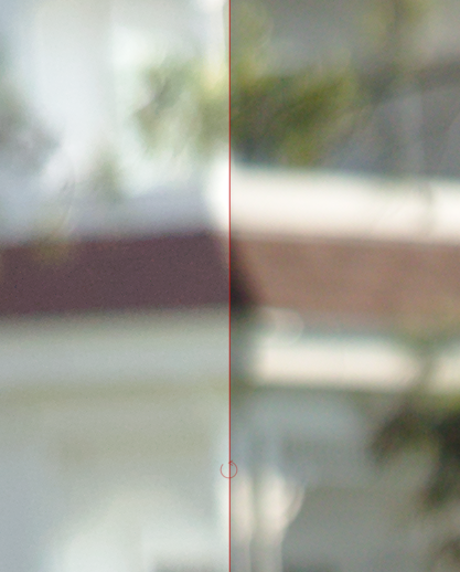

09-25-2024 04:53 PM - edited 09-25-2024 05:29 PM
@jessiesmith220 wrote:
The roof of this building is iconic red (Grand Floridian Resort at Disney World) so anything other than the red shade and the family would definitely notice it and question it. The roof would have been more in the full sun in the few different images I shared where the color disappeared moreso than the shade, just crazy to me that the same thing happened in a few different images taken from different spots, but that in the small corner of the roof it DID pick up the color. Never had this happen before, and I shoot backlit all the time. So so strange! I appreciate you looking at it!
Better? I added a mask and changed the colour a little bit.
