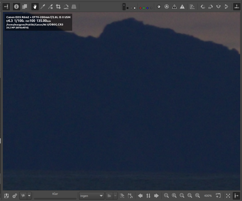

Doesn't look like a laser damage. Is the camera still under warranty?
With RawTherapee you can just hide the bad pixels. I removed the whole column in RawTherapee. I tried to hide only the bright pixels, but the ones between them are also affected.
Link to the text file you put in the dark frame directory in RawTherapee https://drive.google.com/file/d/1EXoBX64CUUGk7xHAt-pRzV0ZRFJmzoru/view?usp=sharing

You just move the file to the directory and restart RawTherapee https://kameratrollet.se/use-rawtherapee-to-deal-with-laser-damaged-camera-sensors/
In the settings in Rawtherapee you can choose the directory you want.
