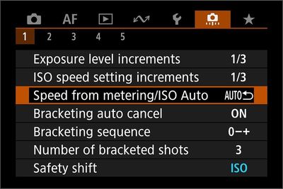

Question for those that use AEB. So I was watching some videos about exposure bracketing. Camera set to Man. ISO 100. and F/2.8. When I do a 3 shot stack it changes the aperture value to change the exposure. But when I run the same settings in AV mode, it keeps the aperture constant and actually changes the exposure. All the videos I'm watching online show that while in M mode, it does not change the aperture. Do I have something set wrong in my camera?

This is on your R6 Mark II right?
https://cam.start.canon/en/C012/manual/html/UG-03_CustomShooting_0050.html
In M mode you choose Shutter, Aperture and ISO
https://cam.start.canon/en/C012/manual/html/UG-03_CustomShooting_0060.html
If you're using ISO Auto then you can adjust exposure compensation.

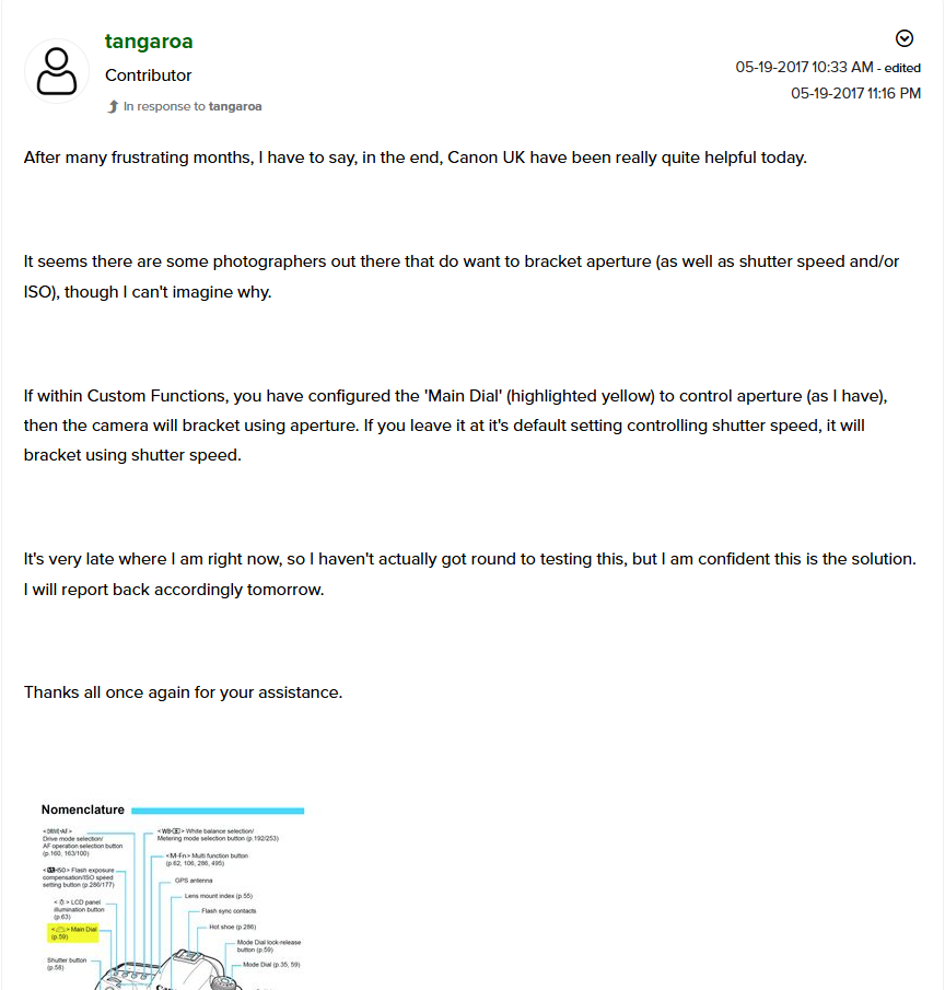

03-03-2026 05:42 AM - edited 03-03-2026 05:43 AM
After doing some digging a lot of digging actually, I'm fairly certain i found the answer in an old post from 2017. (SEE BELOW). I am at work and will try this as soon as i get home but I'm sure this will fix it. Thanks everyone for the input and trying to help.
