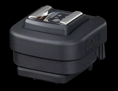

Multi-Function Shoe Adapter AD-E1 (canon.com)
I suggest you check with Wescott FJ to see if their flases are compatible and what your options are.

My older speedlites 430EX III-RT, 470EX-AI & 600EX II-RT are all compatible and fit the multi-function hot shoe of the R6 Mark II and work just fine. But the 600EX II-RT requires the AD-E1 adapter because the speedlite has weather sealing. The OP may need this adapter if the speedlite doesn't fit correctly.

Are you suggesting this adapter will allow me to use those functions with Westcott?
Does the speedlite or transmitter fit correctly in the hot shoe. If NOT the AD-E1 adapter maybe required. Canon says only few of their speedlites, transmitters and the off shoe cord require because of weather sealing. It could be software incompatibility that happens from time to time with new cameras when using older gear.
