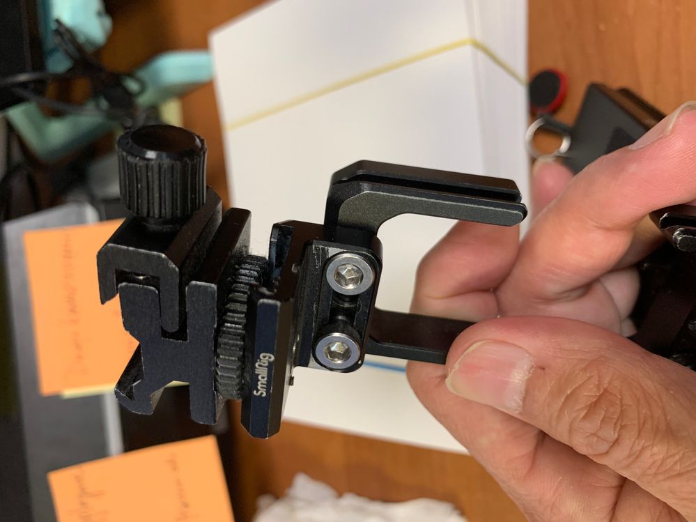

09-18-2024 07:07 PM
May I ask what brand is your bracket? I like the design of it, I will have to start doing this to not put stress on my hotshoe. Mine is currently getting repaired
09-18-2024 07:14 PM
The brackets for both R3 and R5 (R6 is the same) are both Smallrig, I think around $99 and $30 at B&H and on eBay. You need to buy some 1/4" adaptors and cold shoe to put together yourself. Look at the top photo I posted and pay attention to where the flash sits on the cold shoe, be sure to get the cold shoe with a recess on the bottom so when the flash is on it, the contacts on the flash foot do not touch the metal to short the flash.
09-18-2024 07:16 PM
Those adaptors you can find at B&H or Amazon, you also need those blue thread locks so the adaptors don't become loose during a shoot.
09-19-2024 01:11 PM
Thank you! So I was able to find cold shoe adapters no problem, but I notice you have two cold shoes happening here. I’m having trouble looking for the bottom one, I circled it for you. Do you happen to remember the exact name? Been trying to look for it since last night, having trouble finding it. Thank you so much!
09-19-2024 06:26 PM
The Smallrig bracket doesn't come with a cold shoe, so I had to add this angled adapter with cold shoe (flat bottom) so the actual cold shoe the flash sits on is further away from the camera top, leaving just enough space for the trigger. The angled adapter is also a Smallrig brand, but I can't remember where I got it, most likely B&H or Amazon. I have attached 2 close ups for you to see.
