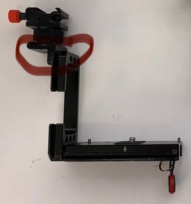

Thank you! So I was able to find cold shoe adapters no problem, but I notice you have two cold shoes happening here. I’m having trouble looking for the bottom one, I circled it for you. Do you happen to remember the exact name? Been trying to look for it since last night, having trouble finding it. Thank you so much!
09-19-2024 06:26 PM

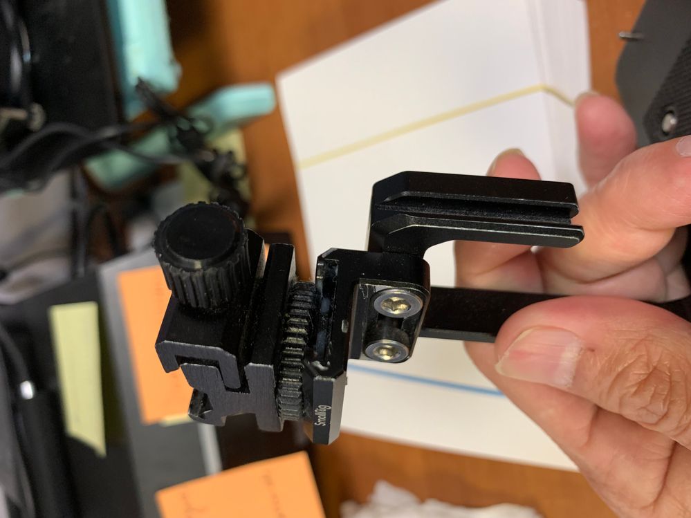

The Smallrig bracket doesn't come with a cold shoe, so I had to add this angled adapter with cold shoe (flat bottom) so the actual cold shoe the flash sits on is further away from the camera top, leaving just enough space for the trigger. The angled adapter is also a Smallrig brand, but I can't remember where I got it, most likely B&H or Amazon. I have attached 2 close ups for you to see.
