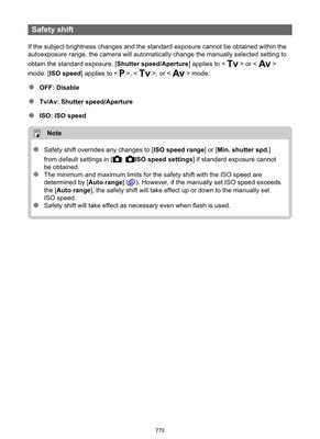

05-28-2026 05:54 AM - edited 05-28-2026 05:56 AM
Note about Safety Shift. The above note indicates that if you manually use a manual setting that exceeds the limit defined for Auto mode, then Safety Shift will ignore the predefined limits and correct the exposure.
The note describes ISO, but I suspect it applies to shutter speed and aperture, too.’Keep Safety Shift disabled.
