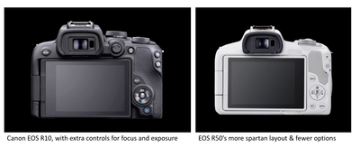

The R50 has a more spartan control layout compared to the R10, for example:
So the availability of controls to support BBF and BB exposure lock is one of the things I always check when considering which model to purchase.
