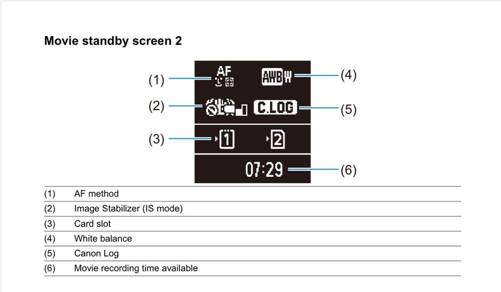

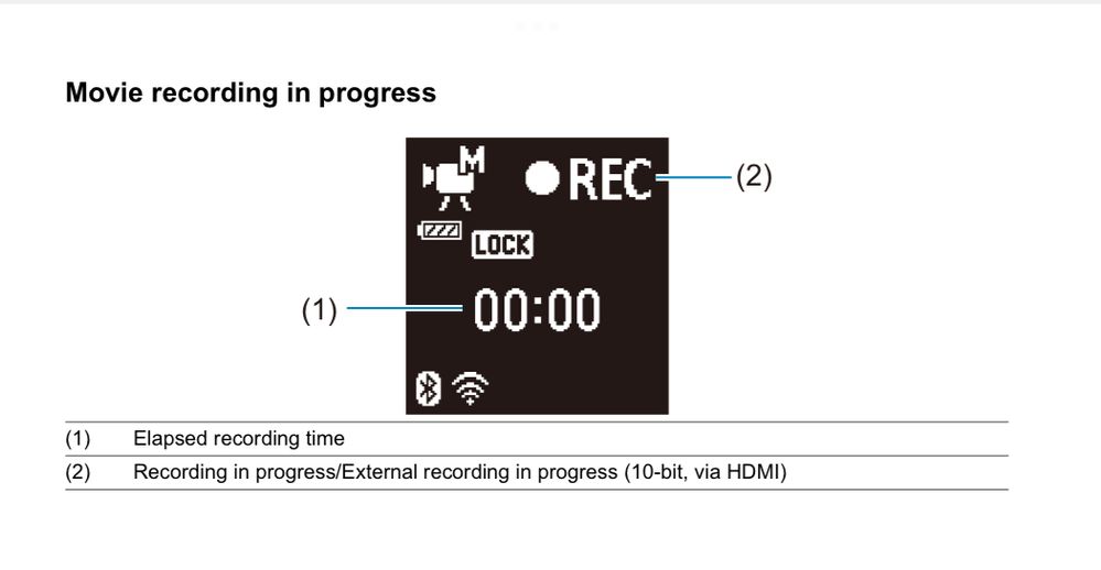

I need a little clarification to understand what you are doing and what has happened during your attempt to capture a time lapse movie. Exactly which icon was flashing? The User Guide does not describe any of the icons as a “manual film icon”. Could you identify it by number?
This is a screenshot of the LCD icons when shooting in stills mode.
This is a screenshot of the LCD icons at the top of the screen when using movie mode.
These are screenshots of the top LCD.
Could you identify it your flashing icon by its number? Was there a different icon flashing in different display mode?
04-27-2024 01:35 PM - edited 04-27-2024 01:37 PM
Thanks for the photo. The icon that was flashing isn’t numbered but does show on your post. The diagram under the title ‘movie recording in progress’, in the top left of the box, the film camera icon with the letter m on it (this signifys you’re in manual film mode which I was to perform the timelapse). That was the flashing icon. I was unable to look at my recorded media and when switched off wouldn’t switch off but remained flashing.

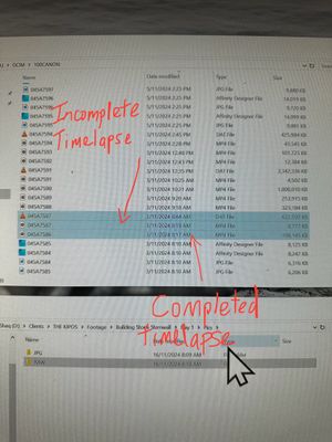

Hi guys,
I have had the same issues. I just noticed that when you check the files there is a corresponding DAT file that is created with the mp4 Timelapse. This particular file is huge. It’s telling me that the information is there but it was not fully converted over to the mp4 file. This DAT file is only created with the broken Timelapse’s. completed Timelapse’s do not have DAT files.
02-17-2025 01:11 PM
I had these issues. It was because I was using an SD card. Upgraded to a Lexar CF card and everything works fine.
