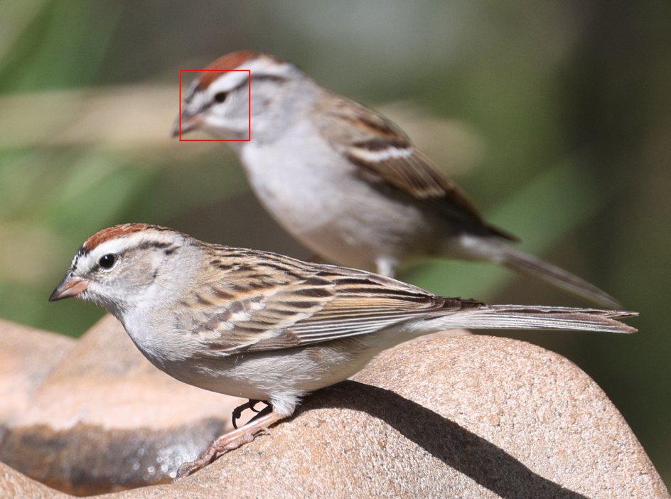

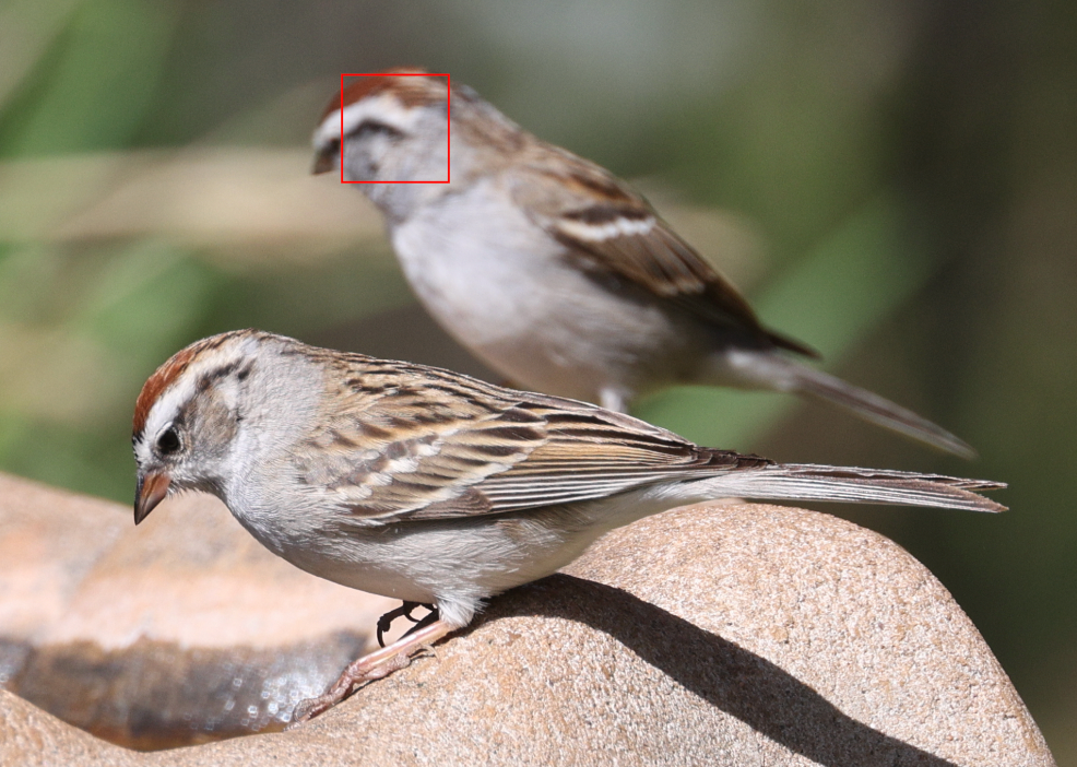

These three images were hand held, Canon EF 100-400mm f/4.5-5.6L IS II USM + 1.4x".
The focus box displayed in the viewfinder and in DPP does not match the actual focus.
I have included 3 screen captures from DPP.
The camera focused on the first bird to land, but the bird took a drink before I could make a photo and the eye was not visible. In the second and third images, a second bird had landed and the viewfinder and DPP both indicated that the new further bird was in focus, but in fact the nearer bird remained in focus. It is as if the view finder and the AF use different algorithms to determine what is in focus.
Most of the following is from exiftool.
Chipping Sparrow (Spizella passerina) at birdbath
original bird still in focus, but DPP indicates newly arrived bird in focus
original bird still in focus but eye of newly arrived bird detected

I do not object to the original bird being tracked and staying in focus. I was surprised that the blue box in the viewfinder (red box in DPP screen capture) went to the eye of the newly arrived bird while the original bird was still being tracked and was in focus. I was happy with the focus choices made by the camera but surprised by the focus indicator displayed. Usually when the camera is tracking a bird, the focus indicator stays on the bird that is in focus and being tracked.
These are screen captures from DPP showing the placement of the focus indicator in DPP. In the first image, the original bird is clearly in focus.
In the second and third images, the focus indicator has moved to the newly arrived bird while the original bird is still being tracked and is in focus as expected. The focus indicator does not show what is in focus.
