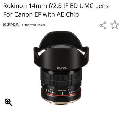

I am trying to use a Rokinon 14mm f/2.8 ED AS IF UMC with AE chip lens on my Canon R5 Mark ii that was purchased new in 2018 for use with a Canon 5diii. (The lens is still available and, from the B&H site, is NOT recommended for the R5ii!) Lens is manual focus without stabilization. Lens is fine with my Canon 5d mark iv. Proper Canon adapter is used. When the shutter is depressed, it seems via sound that an image has been taken; the red recording light goes on but nothing happens...camera is locked up until the battery is removed to reset.
I have tried a number of things: release shutter w/o lens turned ON; when I checked to be sure the focus mode was manual, it was. When I checked to be sure image stabilization was off, it was.
None of this allowed a picture to be taken.
Perhaps nothing can be done, but if anyone has further suggestions, that would be appreciated.

“ This Rokinon has manual focus but diaphragm is automatic. So it’s not fully manual lens. “
This thread is about the fully manual lens that is pictured below, then please start a new.  The lens under discussion is fully manual with a focus confirmation chip.  It also has a manual aperture control ring.

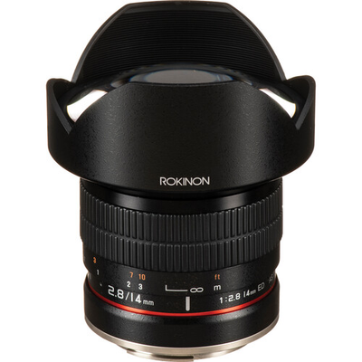

This lens is a fully manual lens.  Just because it may display an aperture setting doesn’t mean that the camera is controlling aperture.
Rokunon does make a fully automatic 14mm lens, but this one is not it.  It has an aperture control ring, something that is not normally used on Canon EF mount lenses with automatic aperture control.
Your photo is correct and I don’t see aperture control ring.
With AE chip
 No AE chip
