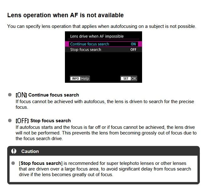

Have you tried the "lens drive when AF is impossible" setting for AF?
06-03-2026 03:50 PM
Tried it but result is the same. Instant lock up when I press the shutter.
