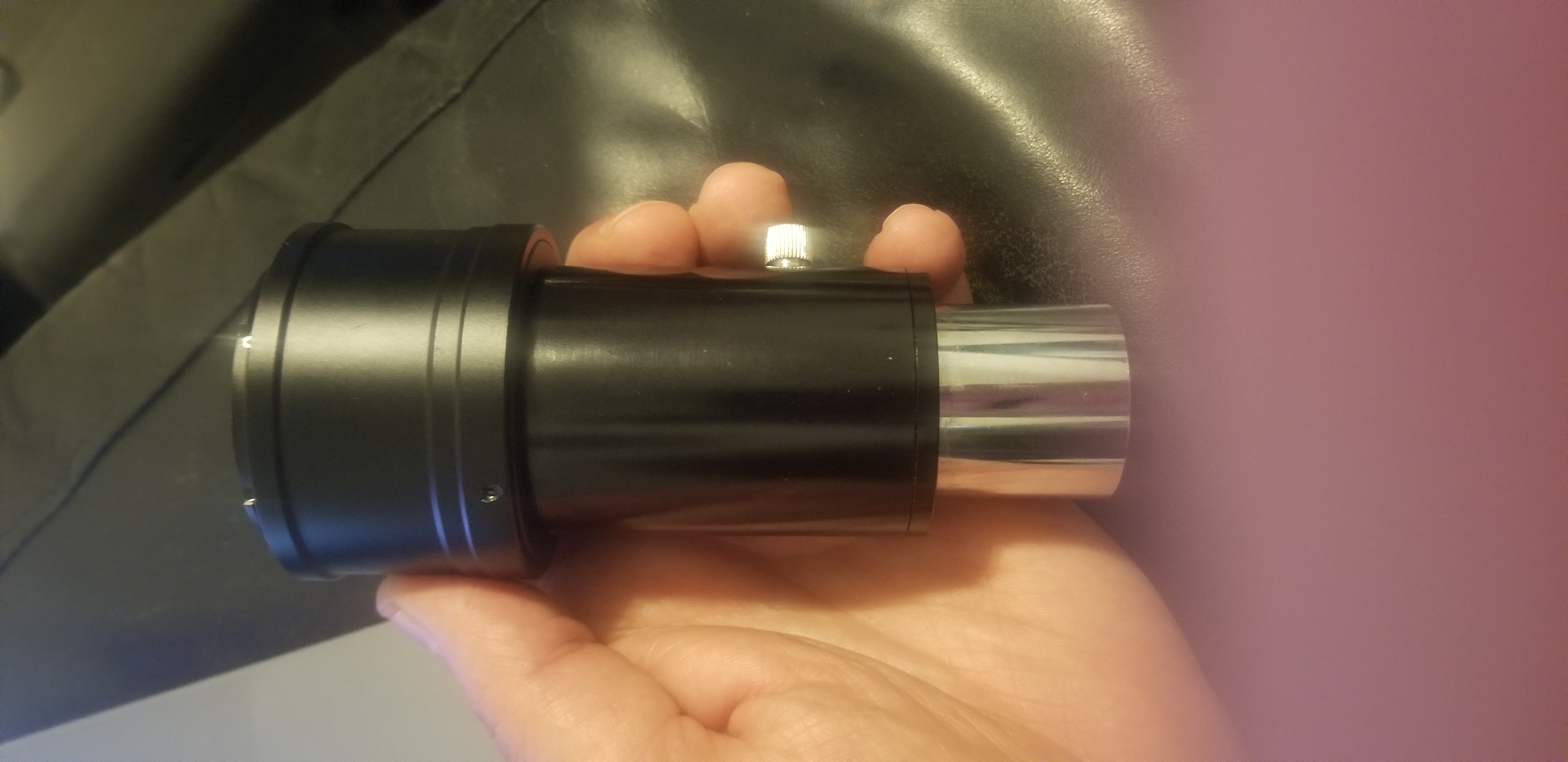

10-15-2020 11:41 AM
Interesting. Here is current setup to attach camera to scope. I see that Meade also has a variable length adapter, which I just ordered from Amazon ($30 and free returns if not useful).
10-15-2020 12:05 PM
That will probably work (long or short enough) you need to get the length correct.
