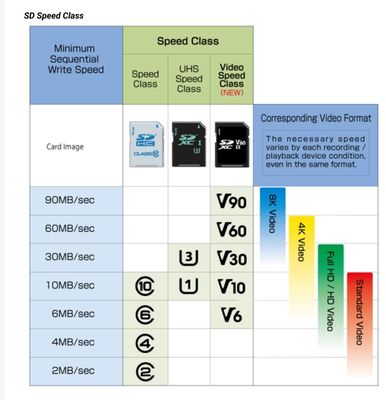

I believe that steve is pointing you in the right direction. Most manufacturers suggest at least a V60 for recording video and V90 would be better. I don't know the M100 well enough but is there an indicator light that will indicate if the camera is writing to the card? If so is it on when the camera freezes?
It sounds like it is a writing challenge, either the card is becoming a challenge or the buffer is struggling.

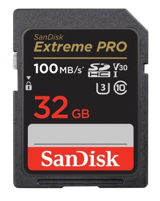

” Thank you so much for such a thorough answer. Yes, I'm using a full-size card. It's a SanDisk Extreme Pro 128GB (200MB/s, SDXC V30 UHS-I), and I did buy it from Amazon, but it was sold by Amazon, not from the marketplace. “
I suggest you purchase a new memory card. Stick to only SDHC cards, 32 GB or less.
If you feel the need for additional storage, then buy two or more SDHC cards.  Some camera models don’t work well with the SDXC cards. So let’s take that question off the table.
Don’t forget to use the camera to format the memory card prior to first use.
