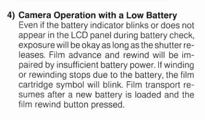

Not sure if the A2e had an internal cell in addition to its 6 V 2CR5 lithium battery. This would explain why the camera doesn't know how many shots its taken.
Film rewind will occur when the last 1-2 frames are shot as long as there is sufficient battery power. You may need to press the re-wind button if the film light is lit. Anything is possible with a camera this old. I remember them doing all kinds of goofy stuff when the battery was replaced. Rewinding the film before all frames were shot, jamming, or people shooting an entire day only to find that the film didn't load correctly and advance. I would not rely on this camera for anything besides snap shots. Film and processing isn't inexpensive either.
EOS_A2E_manual.pdf (canon.com)
