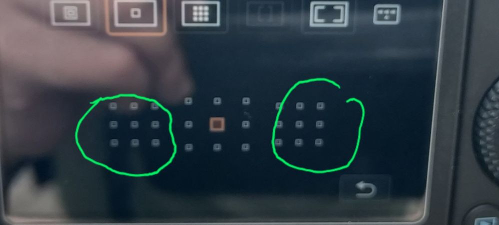

Hello,
My Canon 90D connecting to Canon EF 100-400mm f/4.5-5.6L IS II USM.
When pressing the AF method button ( see image 1), the screen displayed the right and left blocks blinking ( image 2, circled in green).
After replacing the EF with the kit Len, the result was normal. (image 3).
Images 2 and 3 were different.
What went wrong?
Please help
Thanks

There is nothing wrong. From the manual:

deebatman316
Your camera is working correctly not all lenses support all AF Points. The manual list lens groups. Depending on the lens only certain AF points can be used. My 5D Mark IV does the same thing when I attach different lenses. Old Arc Form Drive AF motor lenses from the early days of the EOS system are classified as F/8 lenses. Even though the aperture is wider than F/8. No EF lenses released by Canon had an aperture smaller than F/5.6. The AF motors in these lenses are very slow. That’s why they’re classified as F/8 and only certain AF points can be used. Also these lenses are LIMITED to 3-4 FPS max in Servo AF. This is because the AF and aperture control happen sequentially instead of at the same time. Also the communication speed between the lens and camera body are slow. Even if you use Continuous High shooting the camera will automatically slow down to match the lens’ speed.
-Demetrius
Bodies: EOS 40D & EOS 5D Mark IV
Lenses: EF Holy Trinity, EF 50mm F/1.8 STM, EF 70-210mm F/4 & EF 85mm F/1.8 USM

Hi Demerits
Thank you.
Learned something.
