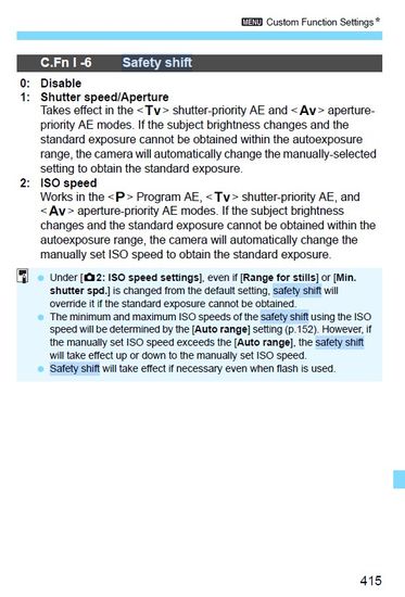

Do you have safety shift turned on in custom functions?

No, safety shift is turned off. I should also mention that auto exposure bracketing, HDR, and multiple exposures are also turned off.

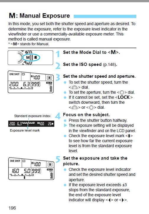

I tried it on my 80D and I believe what you are seeing is the exposure compensation meter switching to an exposure level meter function in Manual shooting mode. Appears to be normal. It is just displaying how far from a normal exposure you have the shutter and aperture set at. Centered, it would indicate a correct exposure.
08-23-2023 06:19 PM - edited 08-23-2023 07:12 PM
See this from the manual (steps 4 and 5 mentions the exposure meter function):
