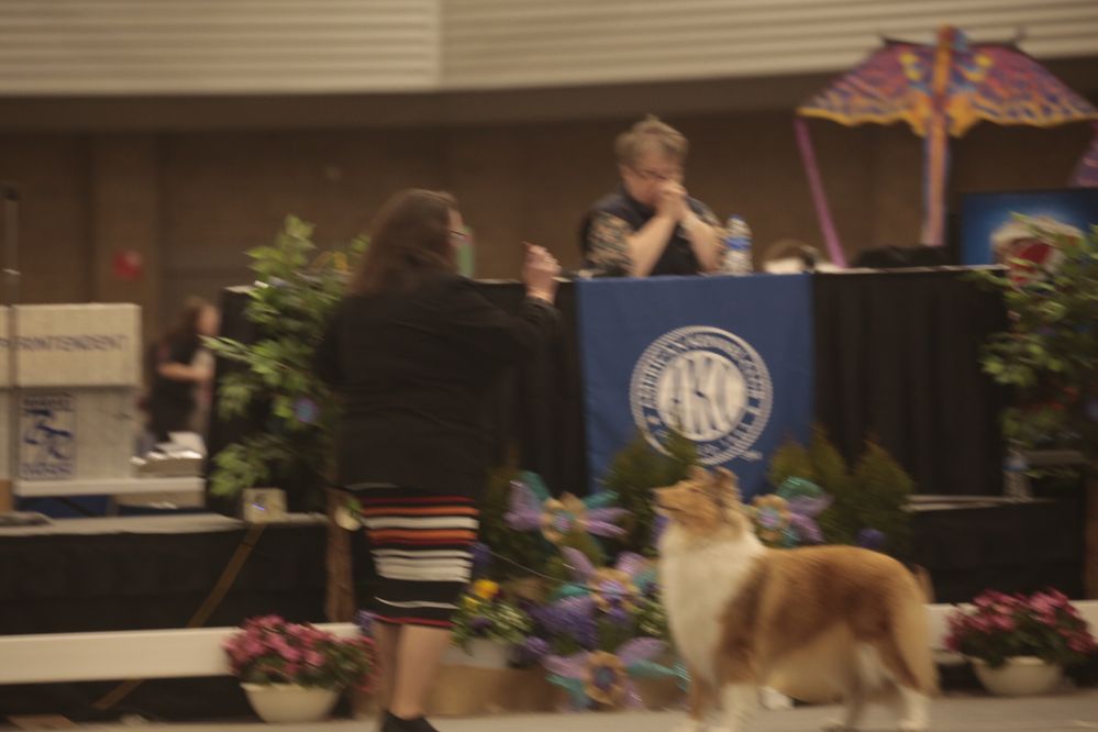

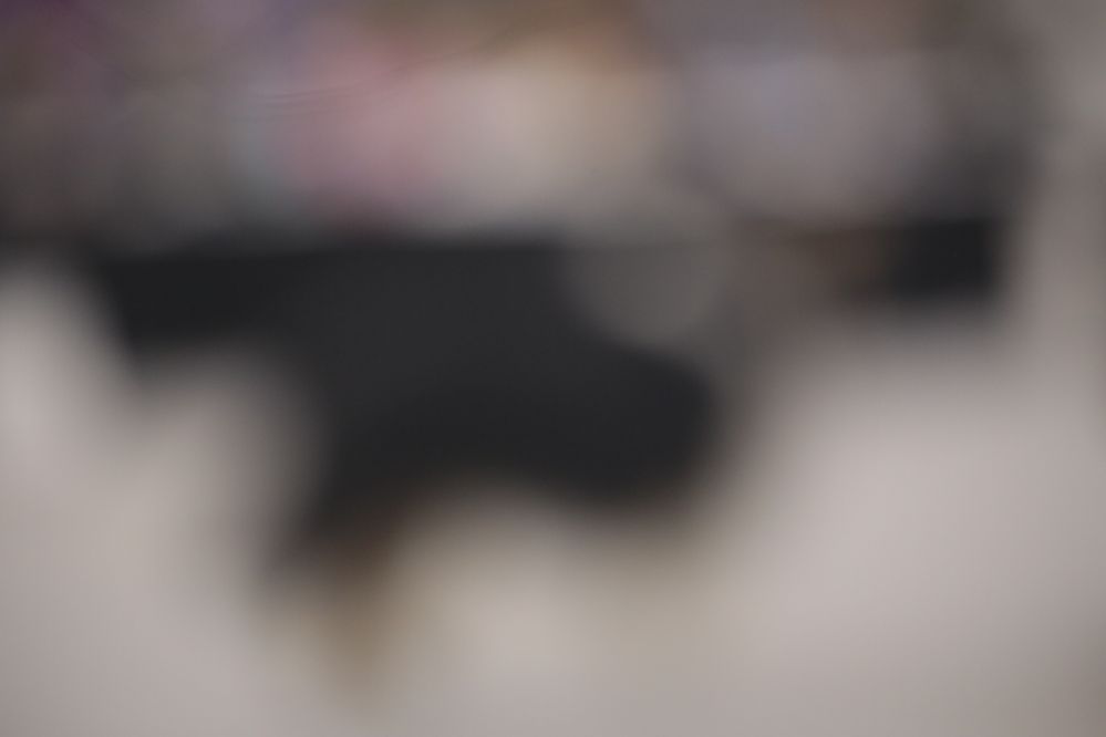

Canon 6D Mark I with Canon 100-400 EF IS lens
Shooting available fluorescent light at an all day, multi-day event when suddenly on day 2 or 3(?) started losing focus. First, slightly out of focus then completely out of focus. All subjects were at least 20-30 feet away. A couple of times, the shutter would not release. Over 2k photos had reasonably sharp focus. I did get samples (attached). I suspect a lens issue, but am not sure. Is there a setting that would cause this? Several times, I noticed changes to settings when pulling out of camera bag. Can autofocus lenses be fixed?

Is it hair on the two first pictures? Something in the way for the AF sensor?

Your images depict a complete AF failure. If there is not a mechanical failure with the lens, its a setting or switch.

Good catch. Hair is likely at a dog show. I didn't notice it when shooting.
