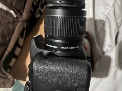

Used it perfectly fine before, suddenly today, when I tried to take photo, it shows Busy (flash icon), and photo is not taken.
Even I changed the mode, switch to MF on lens, the photo goes blurry and the red laser (auto focus) never appear again.

 mode set to Auto (Green), but if I set the lens to AF, they never auto focus like it used to before. And yes, it did job on MF, i even noticed that the lens is not even moving at all on AF, any mode also just flash busy, then most of them is nothing happens, not even shutter click sound coming through.

@putraazlin Did it just stop working? A full name of the lens would be under the lens cap. A lens name would be EF-S 18-55mm F/3.5-5.6 IS STM for instance so please verify the lens name. Have you tried a different EF or EF-S lens to rule out the camera body. If not start there.

I mean, lens not even working by itself on AF, i need to twist manually little bit then it goes auto focus, then the photo can be taken. Otherwise it do nothing even i press the button. If I let AF mode directly without adjusting the focus, it keep showing busy with flash icon.
Even i switched the mode, it still show same error.
I think it about lens faulty. Thanks for your reply sir!

What is the complete model number of your lens?  Look at the front of the lens.   Take a photo of it and post it.
Is it EF-S 18-55mm f/3.5-5.6 IS II ?  This lens has a history of the AF motors getting jammed.
