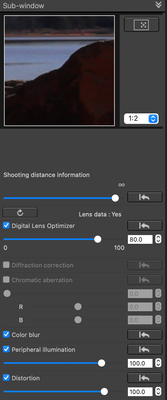

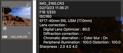

I have EOS R5, so this might be different. But, I hope some of this might be helpful anyway.
To find a photo made with this lens at 17mm on my web server, I ran the command:
egrep -i -l "17-40" ~/public_html/*/*.html | xargs egrep -i "focal.*len"
I had previously used exiftool free software and a Korn shell script to make the html files and did some manual edits of the html files after.
This is one I made with that lens at 17mm:
https://www.rsok.com/~jrm/2023Feb14_birds_and_cats/2023feb013_thunderbird_IMG_3165c.html
