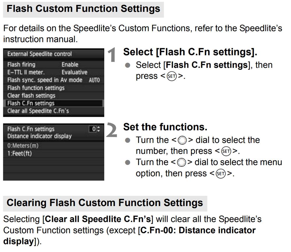

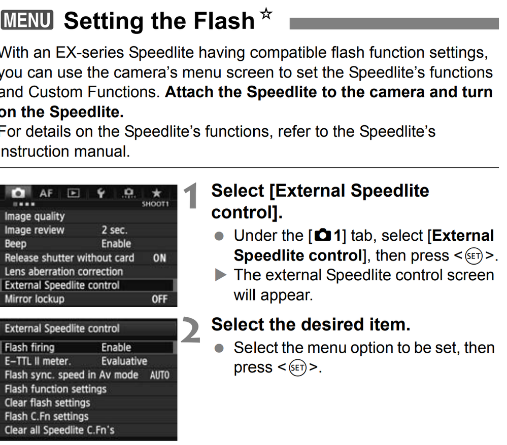

This 3rd Party speedlite claims to work with Canon's Speedlite Control Menu. ( I don't know if it actually works). Speedlite Custom Functions can be changed from the camera's menu screen. Or put the camera in Full Auto (Green Square) Mode this overrides ALL Custom Function. To see if the AF Assist Beam works there. If it works there it must be a camera setting then.
