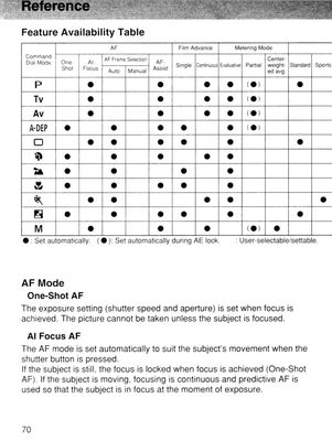

but is normal on that camera that when you do focus the center point I chose for focusing doesn't turn red like on more modern DSLRs and even on the 300v ?
I only hear the sound of the focus and it actually focuses, then I see a green dot that lights up at the bottom where the shutter speed information is.
If the camera is set to AI Servo the focus point(s) don’t light up. That is normal some of the higher end cameras have a choice to allow the AF point(s) to light up in AI Servo.

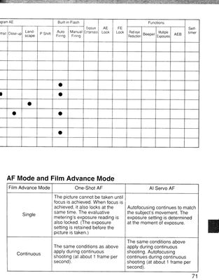

the only indicator at the bottom here that indicates focus ? that is the only one that show a signal when in focus, i don't think that camera have many options change for the focus.
I'm used to the focus point square also turning red, but maybe that doesn't happen with this model, on mine don't happen and i want to understand if is fine or not
It doesn’t the focus mode is preset based on the mode dial. But you can still choose focus points though.
