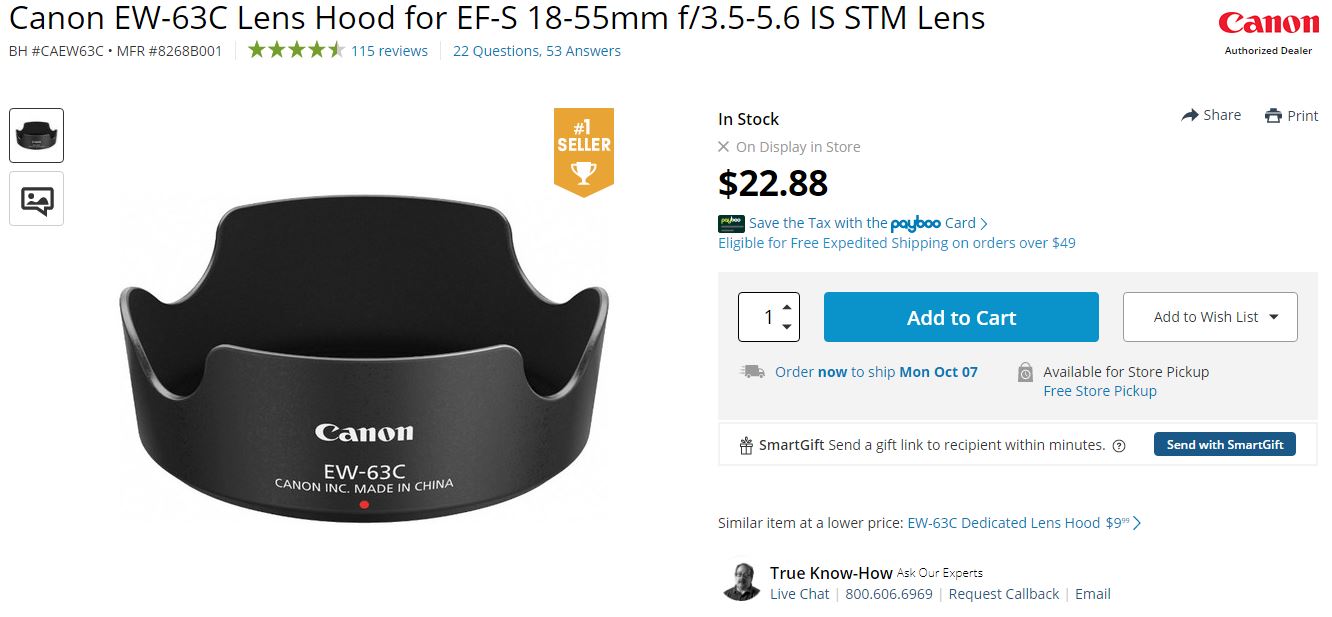

[Links to B&H photo removed per forum policy.  Replaced with screenshots of products offered at the corresponding links.]
The only lens I would buy a filter for would be the EF-S 18-55mm f/3.5-5.6 IS STM.  It has a list price of $250.  I think a $25 filter would be a good thing.  The hood you need for this lens can be found at the above link, EW-63C.
The Canon hood can be mounted in a reversed orientation for storage in your camera bag.  Cheap hoods cannot do that.   You may want to look for used hoods at KEH.
