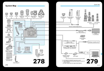

The EIS 1500D/2000D is/was known as the Rebel T7 in the US. The GPS receiver GP-E2 should connect to the hot shoe.  I suggest mounting the GP-E2 and turning it on, connect to a satellite, before you turn on the camera.

kvbarkley
Waddizzle did you read note 2?  It requires the usb cable
“ Waddizzle did you read note 2?  It requires the usb cable “
Good catch. This diagram is from the T7 User Guide.
