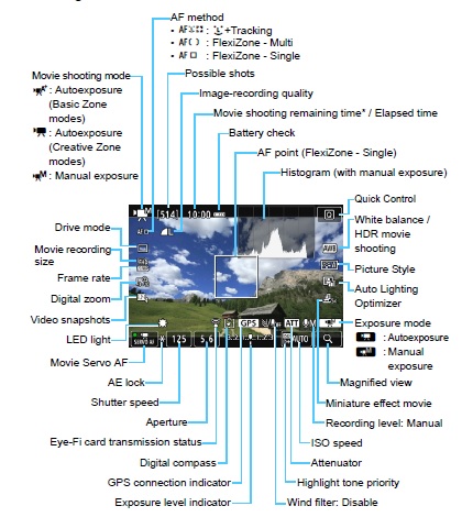

01-16-2020 12:49 PM - edited 01-16-2020 12:54 PM
What I am saying is that if you set the top mode to one of the photo modes, like green square or P, and then use Liveview, the counter won't show up. I think it only shows up if you have the top mode switch in movie mode.
Live Mode Screen:
Movie Mode (Note the Record Time Counter):
