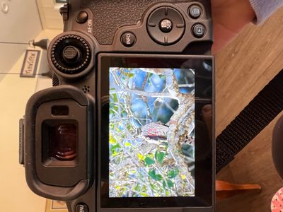

Why are you getting upset? I am trying to tell you the steps I have taken to determine if there is an issue or glitch here. I take photos every day. I playback photos often to review them. I am familiar with the camera.
You wrote - “I see. Just as I thought, that display is not Playback Mode. It is one of the image editing modes. I posted a screen shot from the R7 manual of what Playback Mode looks like. This is what the Creative Assist Editor looks like.”
My response - Here is my photo in playback mode. It is exactly the same as the first photo in your screen shot of what playback mode should look like, (full frame, no other information).
I got here by pressing the PLAYBACK button like I always do.
I could now press the magnify button on the back of the camera to zoom in if I wanted to. However, I have CUSTOMIZED the SET button to perform this action just as I have customized other buttons for BBF, Eye detect etc.
However, when in PLAYBACK MODE, if I press the SET button, I do not get the magnified photo as should be expected, but get this instead:
I have NOT entered any of the menus.
Do you have an R7? Have you tried to repeat my steps as I have described them?
