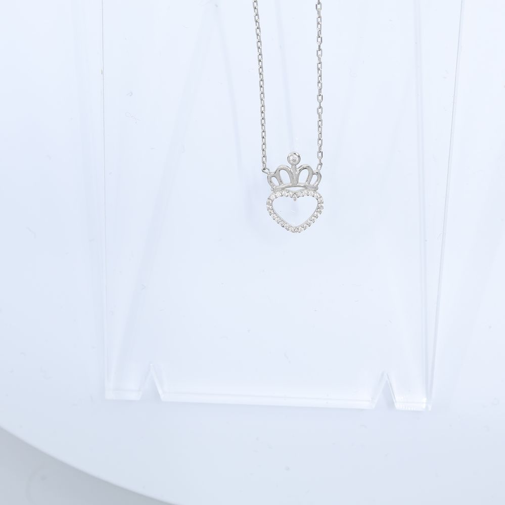

as of today the only thing I changed was making it 8" away from product and it automatically made the shutter speed as 1/60. I am using f8 and here is the result. it solved a lot but I still think it can be better. IMG_0003.JPG

few points:
  • shooting a prime lens wide open at f1.8 generally will produce "soft" images.  if you step it down to 2.8, you'll get a sharper image.  also shooting at f1.8 produces a very small DOF which would mean a very small "slice" of your jewelry will be in focus and the rest will be "blurry" due to bokeh.  Maybe shooting at F4.0 may be better to have more of the jewelrey in focus.
  • did you manually set ISO and shutter?  1/30 shutter is pushing it to limit handheld shake so having a bit faster shutter like 1/60 could help with any camera shake.
-jaewoo
Rebel XT, 7D, 5Dm3, 5DmIV (current), EOS R, EOS R5 (current)
I manually set ISO to 100 and the shutter speed change based on the F value I put (F8). when you mean f2.8 you mean another lens or change the F to 2.8?

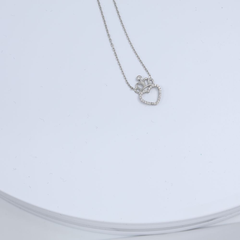

Are you using a tripod?  If so, and your lens has Image Stabilization (IS), then turn that off as it may be fighting with IS.
Is the surface that the jewerly is atop parallel to your camera's lens?  If not, you risk not all parts of the item being in focus, especially if at very wide aperatures and especially so with a macro lens being so close.
This particular image appears underexposed and quite flat contrast-wise.   Do you have lighting you can set up?   Do note though that jewelry photography can be challenging.  I would do an internet search for jewelry photography to get tips and tricks for various lighting setups that would really help to bring out sparkle and to apply very smooth gradients.
Agreed with Steve in trying a darker background.   Though this can be challenging as well since it will get illuminated just as the item, so a black background will turn grey.   You should indeed look what others are using for backgrounds; I image a black velvet may work out very well.

this picture is the best I can get till now. I am using a really good tripod. but the gems are not sharp. can it be better?
ISO 100.
F8.
Sharping level 2.
Exposure +2.
Shutter 1/40
Automatic Focus.
Definitely better, but I do notice a blue cast to the image.  Several solutions, though definitely capture in RAW:
  1. Try Auto White Balance (AWB)
  2. Use a camera preset (or custom Kelvin value) to have the captured image be more neutral.
  3. Adjust in post-processing (when using RAW, the white balance is not baked in, so you can easily adjust it)
  4. Use a custom white balance.
Beyond that, do you have access to a flash/strobe or continuous light source?  That could help out with adding more specular highlights.
