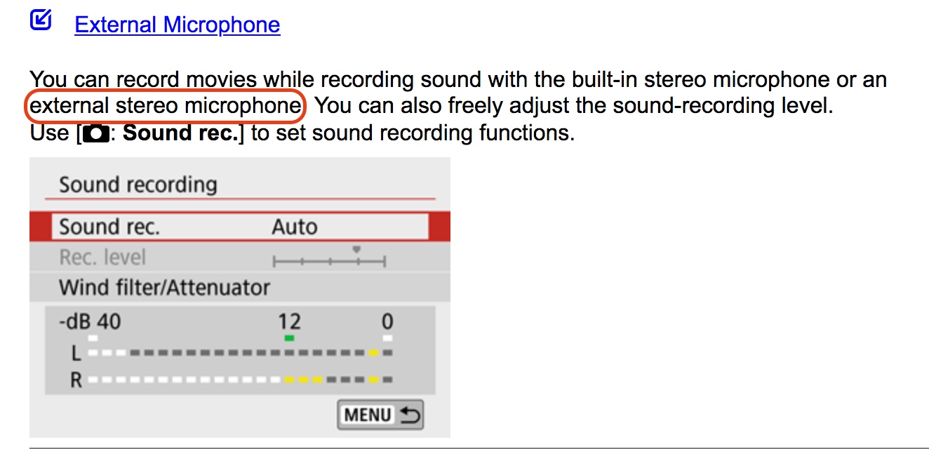

The M50 -II Manual clearly states in two places thet the mic input is stereo. In fact Canon actually sells a variable angle stereo microphone, the for use with this camera. I don't have a M50 to test, but from the published Canon literature, the audio input does appear to be fully stereo.
Are you sure you are using the proper stereo imput cables and/or adapters to access the mic input jack. Canon DSLRs and Canon Mirrorless cameras use a single TRRS input with the left channle on the tip and thet right channel on the first ring.
To input a stereo signal from two XLR mic(either dynamic or battery powered condensers) the left XLR pin-2 must connect to the 3.5 mm TRS tip, and the right XLR pin-2 must connect to TRS Ring-1. This generally is best done with a dedicated Dual XLR to TRS "mic splitter cable".
NOTE: Using a much, much more common TRS to dual TRS splitter and then a couple of XLR to TRS adapters will NOT work and will result in mono recording. Standard dual TRS to TRS or dual TRRS tosingle TRRS splitters are inntended for headphone use and are wirred with all connectors in parallel. They don't provide the Tip too LEFT and Ring to RIGHT separation required for stereo input.

UPDATE: Canon Tech support has confirmed that it cannot record the left and right signals from the 3,5mm TRS stereo mic input in 'true' stereo. It will mix both tracks together.
Here is what tech support told me:
"Regarding the way the camera records audio, it is true that it will combine the audio together and it will not allow for separate channels to be recorded independently to their own left and right channel tracks per the external microphone that is used. [...] When recording video on the EOS M50, a stereo mic can be used, but per design of the camera, it will merge the audio together to where the left and right channel will have the same track."
