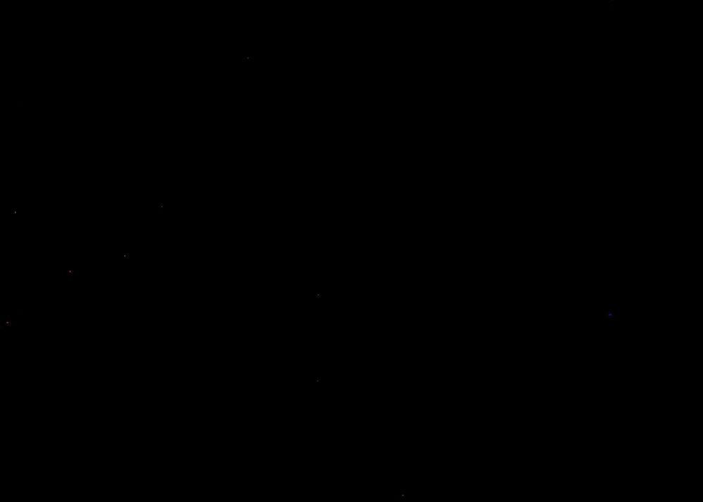

Hello to everyone,
I have bought a Canon R6 MKII about 6 months ago.
And i notice some red dots on a pictures with some long exposure 5s to 10s and iso around 400/800.
I have done sensor cleaning and manual cleaning to see if they go away, but they only reduce the brightness and size, and now i see white and red dots, small but a lot.
Can some one give me some opinion ?
Thank You/ Kind Regard's
Vitor

I had guarantee in January 2023, but all sensors have the same issue. The R3 in the link above had around 400 at 15 seconds and ISO 6400.
So to deal with it in your case:
  • Remove them in post in your raw converter
  • Use a dark frame (LENR)
  • Shoot at ISO 12800 and above (auto removal with R3, R5, R6, R6 II)
  • Sensor cleaning method (works best with hot pixels at short shutter speed)
  • Cool down the sensor
Sony tried to deal with hot pixels with an auto removal feature. I think you have heard about star eaters and Sony.

I also recommend you stop trying to clean the sensor.
You can map out the pixels here is a basic method that I believe works on most Canon cameras
  1. Make sure you have a fully charged battery.
  2. Detach lens and put the camera body cap on.
  3. Go into your menus and find Sensor cleaning.
  4. Select Clean manually.
  5. Let it run for 60 seconds, turn off the camera.
  6. Turn it back on and try it.
EB

If your Fujifilm doesn't show hot pixels it may have a built-in hot pixel suppression feature, see what I wrote about your R6 II at ISO 12800 and above. With 6D it happens already at ISO 6400, see my raw files here and compare them side by side. Don't use a raw converter that auto removes hot pixels if you want to see the difference (Adobe) https://kameratrollet.se/wp-content/uploads/2022/11/hot-pixels-ISO6400vsISO3200.zip
Peter
On mine it show on low ISO, dont know why and high ISO does not shows, and with the LNR and LNER turned off always.
I will see my test on different ISO with the LNR and LNER turned on, and i will give some feedback.

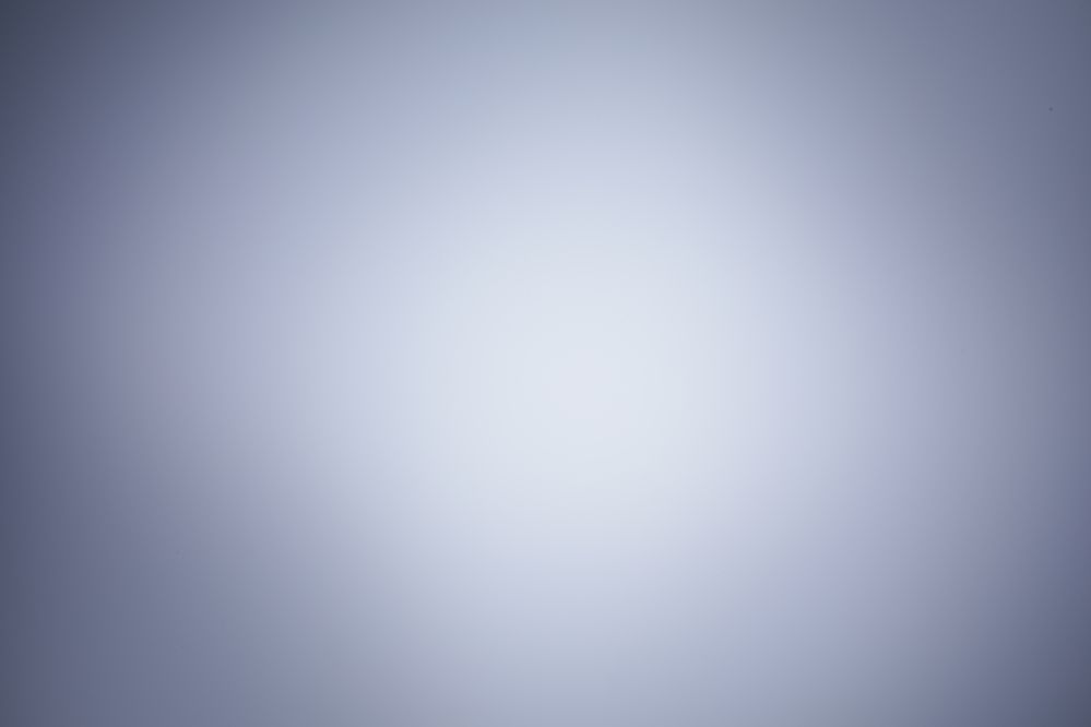

I send the camera to Canon, as warranty, and today i have received they thought about this.317A4198_sensor_dust.JPGhotpixels_zoom.jpgsample.jpg
- For them this is not Hot Pixels, is sensor dust, and i have to pay 121 Euros - to clean.
Can you believe on this ?
Kind Regard's to All

Cleaning does not get rid of hot pixels. It is a problem in the actual silicon, below any filter or bayer array.
Your right! but Canon support says it is Dust on Sensor and to clean to pay 121 Euros.
Very Bad Service!
