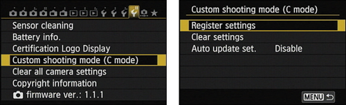

Set the camera to a mode OTHER than the custom mode. Configure the camera to all the settings that you want. For example, if you want to set the "Custom" mode to use Shutter priority (Tv) with a shutter speed of 1/1000, ISO 800, f/4, AI-Servo focus, etc. etc. then you pretend your camera doesn't have a "Custom" mode and just set the camera up as you want.
Next, use the menu and access the Yellow "Wrench" icon with 4 dots. Select the "Custom shooting mode (C mode)" option on that menu. This opens a new sub-menu as shown here.
Select the "Register settings" and press the 'Set' button.
At this point, you've "registered' your custom mode. You could change modes, completely change all settings... but when you return to the "Custom" mode ('C' on the mode dial) the camera will immediately revert to those settings you set for the Custom mode.
However... look two rows down on that menu to the option that says "Auto update set.". It's set to 'Disable' by default. If you "enable" this feature than anything you change when in "Custom" mode will be remembered.
This is a dangerous thing to enable because it means you're going to have some configuration drift... in other words unless you've got an incredibly sharp memory... you can never be quite so certain what you're going to get when you switch to the "custom" mode. For this reason, the "Auto update set." Is disabled as a factory default.
I hope that helps!
