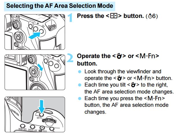

@Stillh2o wrote:Just to make sure I am understanding what you are saying, if I am in single point AF in Servo, the single point will not expand to 3 or 4 points together and track the subject I am foucused on?
Correct. It will longitudinally (moving away or towards you) but if it moves laterally it won't with a single AF point. You need to choose a mode that has multiple points and it will auto select the point for you as the object moves laterally. Usually the most effective is the center point with 8 assists. I use it 95% of the time for BIF.
What you want is to be in an auto AF point selection mode.
All Canon dSLRs behave differently when it comes to auto AF point selection mode and AIServo compared to One Shot focus mode.
When in an auto AF point selection mode and One Shot the camera will choose from all available AF points and choose the closest active AF point that has adequate contrast to achieve focus.
When in an auto AF point selection mode and AIServo, the camera starts with a single AF point and uses the other active AF points to continue to track the subject if they move away from the starting AF point.
For most Canon dSLR the starting point for tracking when in auto AF point selection mode and AIServo is the center AF point. Starting with the classic 7D more advanced cameras allow you to choose a different starting point for focus tracking when in auto AF point selection mode and AIServo. Just to confuse things the 7D Mk II also allows you to set it up, so it will automatically choose the starting AF point, much like other cameras do in auto AF point selection mode and One Shot. This however is not the default way the camera is set up, and you would need to reconfigure it to do that.
So what you actually want to use is either the 65 point auto AF point selection and AIServo, or one of the Zone auto AF point selection modes and AIServo. This will start with a single AF point, and if your subject moves off that AF point laterally the camera will hand off focus to one of the adjacent active AF points and continue tracking your subject.

Normally you do that by allowing it to use all the AF points (set it to use the full AF area... not a single point), BUT... you set the initial point and the focus system will attempt to "track" your moving subject. In other words it doesn't really use all the points at the same time... you give it permission to switch to adjacent points as needed to follow your subject movement. It really just focuses to the one point -- but using the full AF area gives the camera permission to switch points as your subject moves. If you pick a "single" AF point then you've locked it only that point and it is not allow to transition to adjacent points as your subject moves.

My question was where to go to activate what I wanted it too do, not how to use the AF. I found where I needed to go in the settings to accomplish that.
