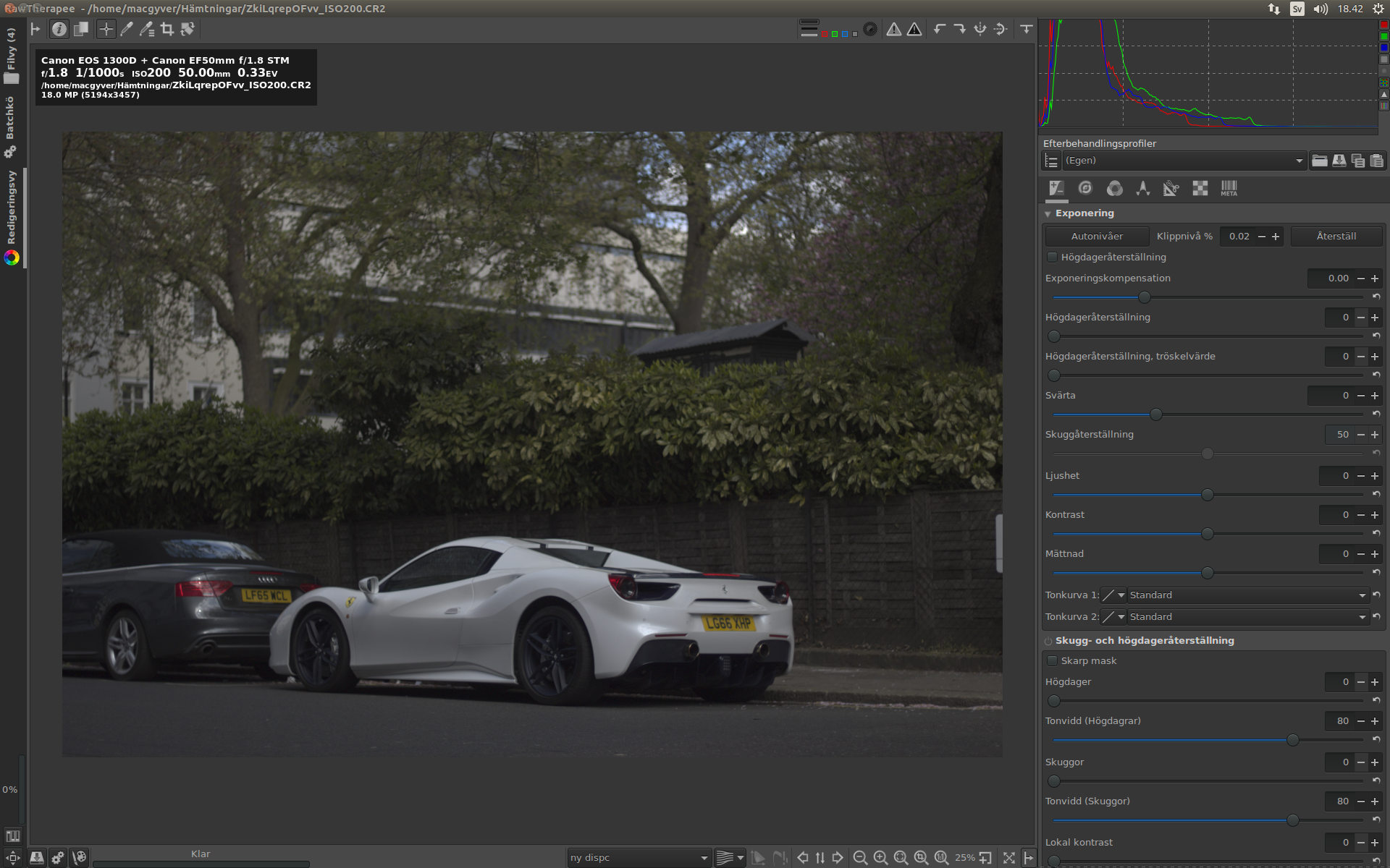

If you take a look at the raw histogram, you will see that you could have collect more photons. Instead of 1/1000 sec you could have used 1/500 sec or 1/250 sec without clipping the highlights. The focus seems to be closer than the car. Live view is slower but focus more correct than using the viewfinder.
I also think this may help you http://community.usa.canon.com/t5/EOS/Image-output-from-RAW-is-grainy/td-p/203149
If I would have taken that scen, I think I would have used f/2.8 to eliminate a digital ISO boost (check the link) and to get sharper image. I would also have used ISO 100 to be able to collect more photons and perhaps 1/125 second to get the histogram exposed to the right.

https://ibb.co/jLU2T5 - ISO 200, the metallic on this Ferrari 488 looks like something completely different. Thanks
Great, thanks a lot, I will look on that link now and the composition/ Distance is only to suit the instagram crop (dead). Really appreciate that!
