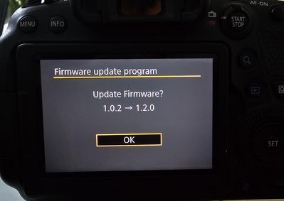

The image, on its own, is not very informative, so explaining what is going wrong would be helpful.
At a guess, I suspect your update is stalled at 99%  completion - is that correct?

Thanks for the reply.
It did not reach 100% and resetting with battery removal did not work.

Yes, you are right. The camera is dysfunctional. I have followed the instructions in the manual, but still, the issue persists. I have inserted a new battery and an SD card.
"Can you please explain how to reset the camera without having to update the firmware?"

If the FW update did not complete and the camera does not function "dysfunctional", there is no way to reset the camera or its settings to defaults.  You will need to contact Canon Support and send it in for service and/or repair.
I have been waiting for an hour, but my device is still stuck at 99% completion. Additionally, the camera is not functioning properly and requires me to remove and reinsert the battery. Even after doing so, I am still receiving the same message and it continues to reach 99% againWhatsApp Image 2024-01-31 at 05.39.09_c8b0f293.jpgWhatsApp Image 2024-01-31 at 05.39.09_c8b0f293.jpg. None of the buttons on the device seem to be working.
