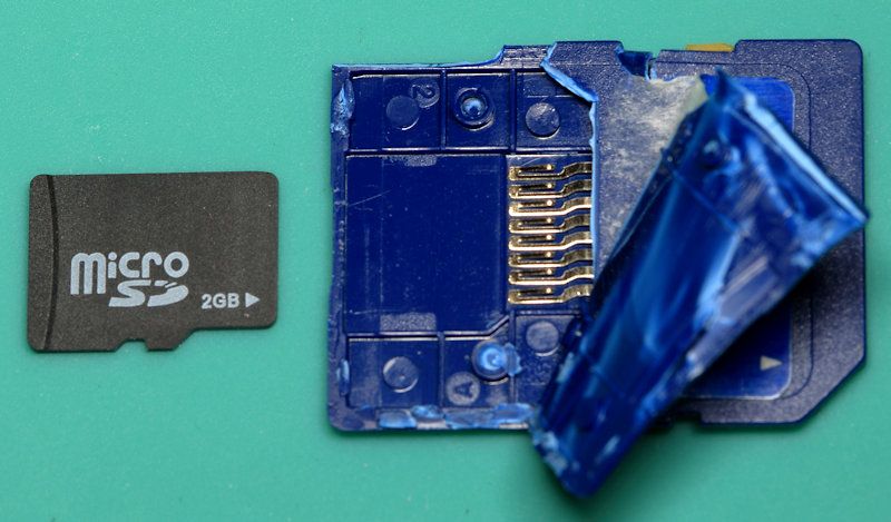

Sometimes, SD cards are NOT what they appear to be. And counterfeit cards can have a very convincing label put on them that resemble a better known brand name.
https://community.usa.canon.com/t5/General-Discussion/SD-Card-surprise/m-p/298627
