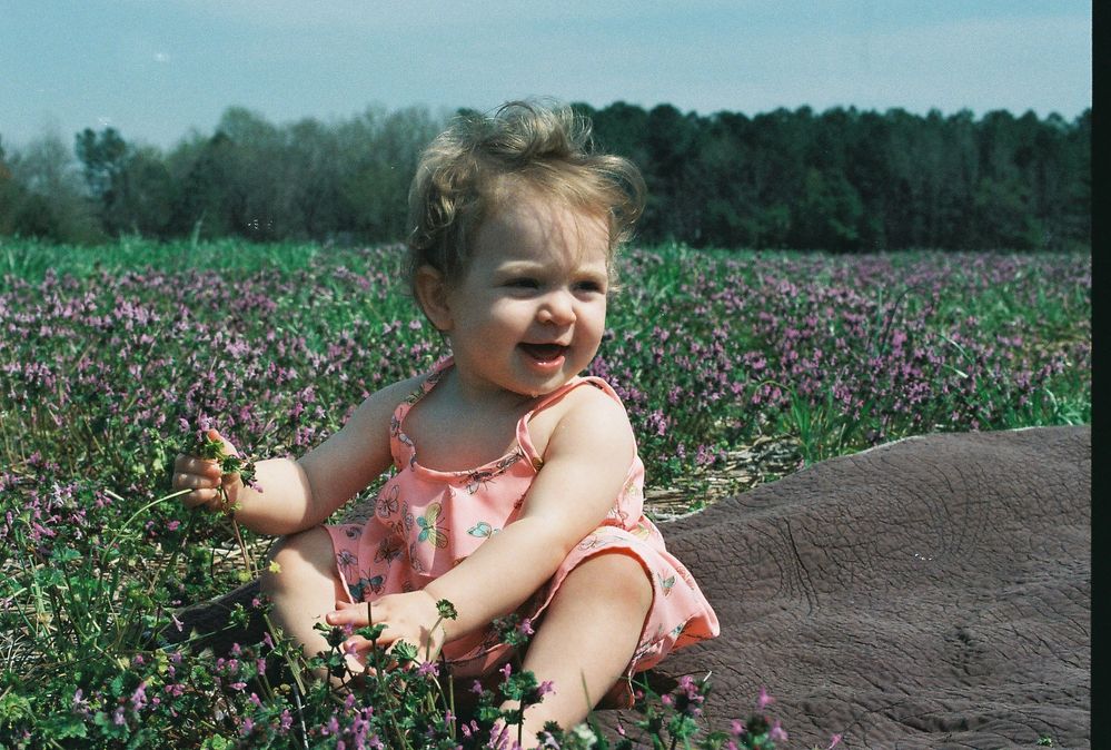

OK....So I have a film camera, Canon EOS3- Not exactly a common things now-a-days-but I would dare to say it is comparitive to a 7Ds quality. I am all of a sudden running into this problem below where I get a black line running down the edge of my photos- about 5 rolls of fims straight- 2 different brands, Fuji & Kodak.. I have been having to crop it out of all of my images. It's super aggervating. Unfortunately, I moved into a small town who only has one place that still develops film. So, I am not sure if it is soley their equipments/ employees fault or there maybe something I need to do to my cameras setting, or maybe it's the way I may be putting in the film?-or gasp** it needs to be serviced??! I am so confused...I also have a second error. These two may be related and perhaps this maybe the cause of those lines. I have been experiencing a "BC" error occasionally while shooting where my shutter lags in mid-pic. So, I may be answering my own question here...Maybe, that is the culperate? I am using rechargable batteries in a PB2 grip. The batteries are ALWAYS fully charged for each shoot, because I just think rechargables just dont have that same oomph as throw-a-aways. I have been using the camera for about 7 months with out these issues.
Any advice or similar experiences??
Please help!! 🙂 ...Here is a pic of my sweetie below with that issue..

Test the shutter by using different speeds & looking through the lens from the film side of the camera (with the back open). Is that line on the negatives? It may be a printing problem. Compare recent negatives to older ones. The exposed width should be exactly the same, & if it is then it's something to do with the printing process.

Regarding the black line on your images...
It looks to me as if the operator at the photo lab simply doesn't have the film strip properly inserted when they are making the scans. Many of the machines used to make prints also are used to make the scans (they use the scan to make the print, actually)... And they are supposed to detect and align the images automatically. I'd guess it's either their equipment is off, out of adjustment, or operator error on their part.
I'm pretty sure that's a printing problem. I can't think of anything that you could do to a film camera or any fault of a film camera that would give that type of error. Talk to the film processor and show them your images. They are probably doing that to everyone's film.

Thanks Cicopo for your suggestion. I will need to try that tonight to see if anything sticks out or not. I did grab a few different negatives from different periods, and the lines are not in the negatives 😕 ....Amature question here, what do you mean by exposed width??

Thanks for those who have responded with their insight!! Regarding the black bar, I have switched to a different develpor. I did not tell them about my issues just to see what happens, and NO black bars..yay!! SO, YES- I would agree it was a developing issue. Shame on them.
