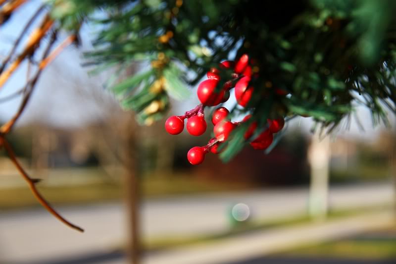

It is possible to get a blurred background with the T6 and 18-55 kit lens, but you have to use 55mm at f/5.6, and then focus on a subject close to the camera with lots of open space behind the subject.
Here is an exmple shot at 55mm and f/5.6
