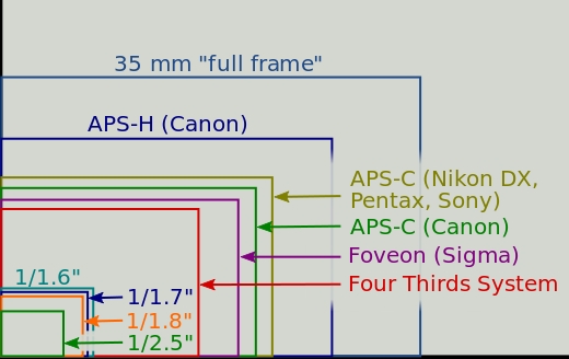

No, it would be impossible to make such an adapter.
The image sensor on a 4/3 camera is much smaller than on a APS-C camera like the EOS M. The 4/3 lens would not be able to project an image large enough to fill the entire sensor on a bigger camera.
Another thing to consider is that even though your EF-M lenses are APS-C, they will never work on an EF-S camera because the flange-to-focal-plane distance is shorter with mirror-less cameras like the EOS M.
