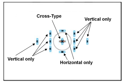

Yes, just keep the active AF point on your subject and you should be fine, but for best results just use the center AF point.
On the 6D, only the center AF point is a "cross-type" and it will be the most accurate when it comes to achieving focus. This is because it can detect both horizontal and vertical lines simultaneously. The others will not be as good at acquiring AF because they only react to either vertical or horizontal-lines depending on which point you select.
The AF area is actually slightly larger than the black square and is represented by the blue rectangles in the photo below.
