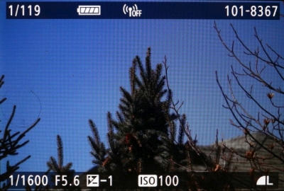

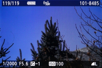

Hear is how I establish the jpeg buffer:
Starting with no photos on the card I just shoot until the fps starts to slow down. If you subtract the image number of the first photo from the image number of the last photo, you will get the number of shots in the buffer.
8485-8367=118
You can also use the “play” button to display the image on the rear LCD. The “info” button will give you the total image count in the top left corner.
8485-8367=118
