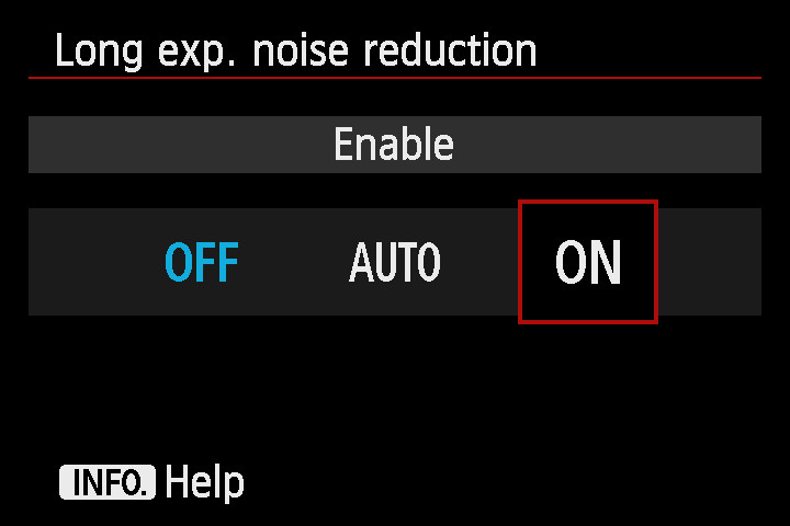

Hi. I have the same problem when I'm taking photo for long exposure and make shutter speed to about 5" till 30" sec. after taking it says busy....please wait. memory card is 80 mb/s so what's the problem how can I fix that?
05-25-2020 05:21 AM - edited 05-25-2020 05:22 AM
@sarwaar wrote:Hi. I have the same problem when I'm taking photo for long exposure and make shutter speed to about 5" till 30" sec. after taking it says busy....please wait. memory card is 80 mb/s so what's the problem how can I fix that?
Turn off long exposure noise reduction.
