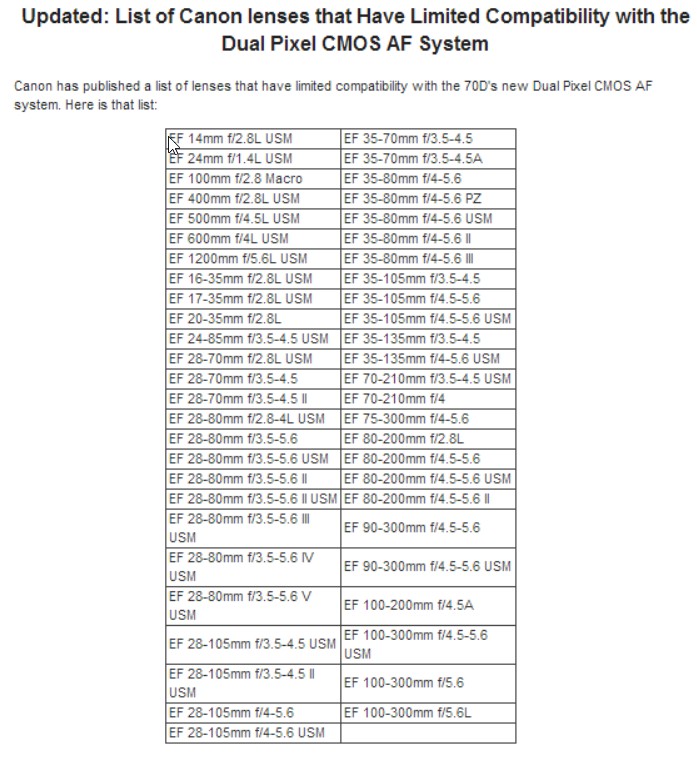

To OP, the Tamron 18-270 mm f/3.5-6.3 ranges from f/3.5 on the short end (18mm) to f/6.3 on the long end (270mm). The D70 has a unique autofocus system which utilizes the sensor pixels for accuracy. Canon has identified certain Canon lenses which have limited compatibility with system.
My guess is that your lens does not offer full compatibility in part because of the too small maximum aperature of f/6.3 on the long end. This is pretty much the extent of the knowledge I was able to gleen from the web in a short while. Good luck with your work or play.

Are you kidding? Lenses like the 100mm Macro, the 16-35L, the 24 1.4, and a bunch of the long primes? Those are some quality lenses to obsolete on your new AF system Canon. Not to mention third party lens troubles. I'm really surprised, I didn't realize the dual phase system was going to cause issues with current lenses.
