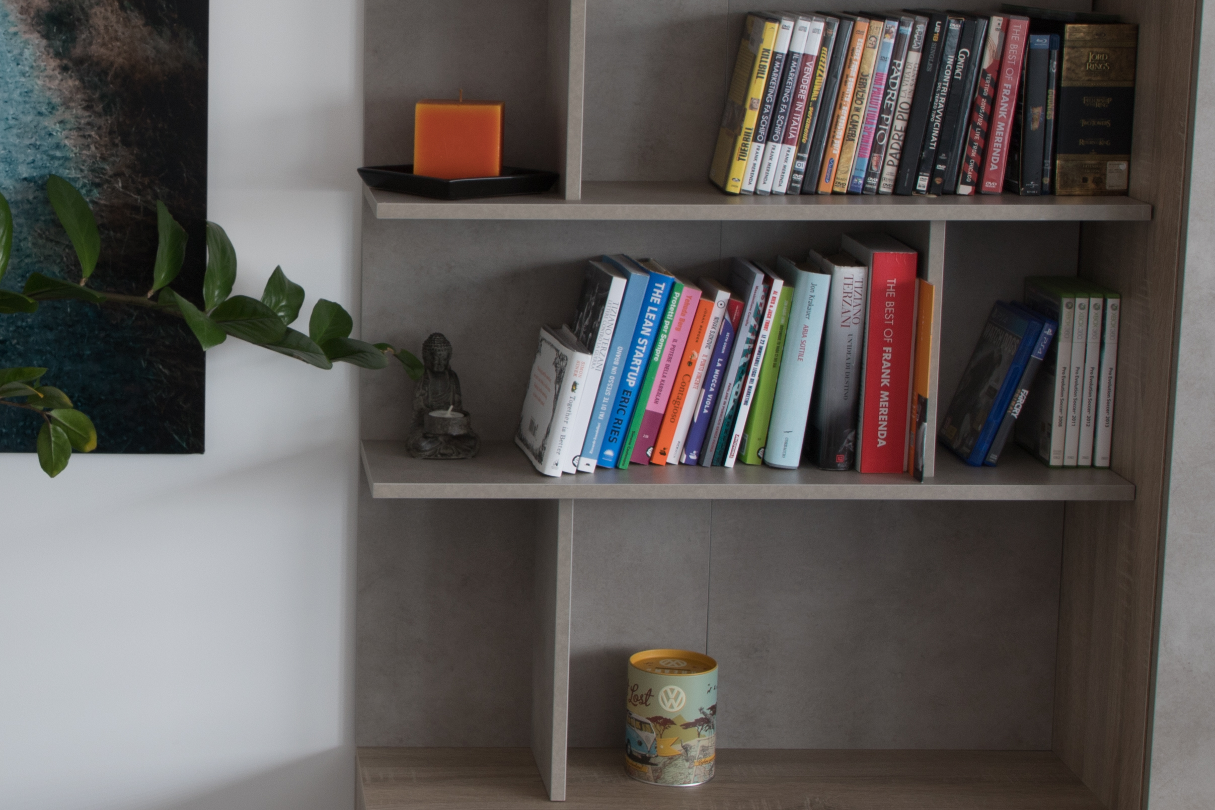

Hi,
recently switched from a Nikon D610 to EOS 6dMkII with a 24-105 f4 II lens.
Compared to my previous camera, I noticed that the sharpness of the photos is much much lower (before I had a 24-120 f4 Nikkor, so quite similar).
Also shooting with tripod, at ISO100 and f11, as in the attached photos. You can zoom on books to see the lack of sharpness.
Firmware updated, with the stabilizer deactivated the difference is still minimal (in the attached photos it is deactivated). I also tried to reset to factory settings.
Am i doing something wrong or it is just the camera/lens standard result?
Thanks
ISO 100, 31mm, f11, 10s. on tripod
Exported from Lightroom at 4000x2667, 100% quality, 240dpi
Crop 100%

Hmmm D610 to 6D Mk II ? That's an odd swap. They are pretty similar cameras. Add the two lenses you have also pretty similar. Curious, why did you do it?
Actually, I think the ef 24-105mm f4L is better, albiet slightly, than the Nikkor 24-120mm f4. However, I don't have a D610 or a 6D Mk II. Do you do lens correction in LR? You need to. I set that up as a preset so all my photos get lens correction upon import. Try it and see what you think.

01-25-2018 10:38 AM
Even from the 100% crop it is difficult to see where the actual point of best focus lies but your lens may be front or back focusing. I just went through the calibration process with my new 1DX Mii and all of my L series were pretty much dead on but the 85mm F1.8 required 3 steps of adjustment to correct its front focus issue.
Download the Canon brochure on checking/adjusting this part of the camera/lens setup: https://www.learn.usa.canon.com/app/pdfs/articles/AF_MicroAdjustGuide_desktop.pdf

"Even from the 100% crop it is difficult to see where the actual point ..."
I agree totally. Plus the angle may be different between camera and subject of the two lenses the OP is comparing. There are just so many variables in making a judgement with shots like this.
01-25-2018 02:03 PM
It turns out that i had some front focus on both wide and tele (W +3 T +5!).
I've double checked both with the traditional chart tests and the DotTune method.
Tomorrow i will try the same shoots with the same lights to see how much did this impact on photos and i will update you.
