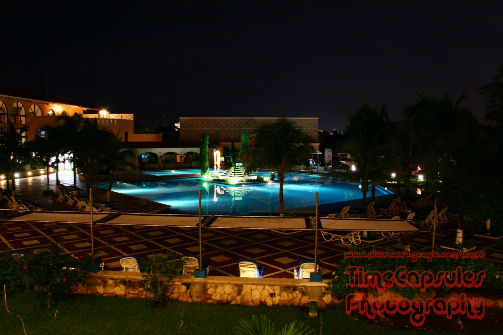

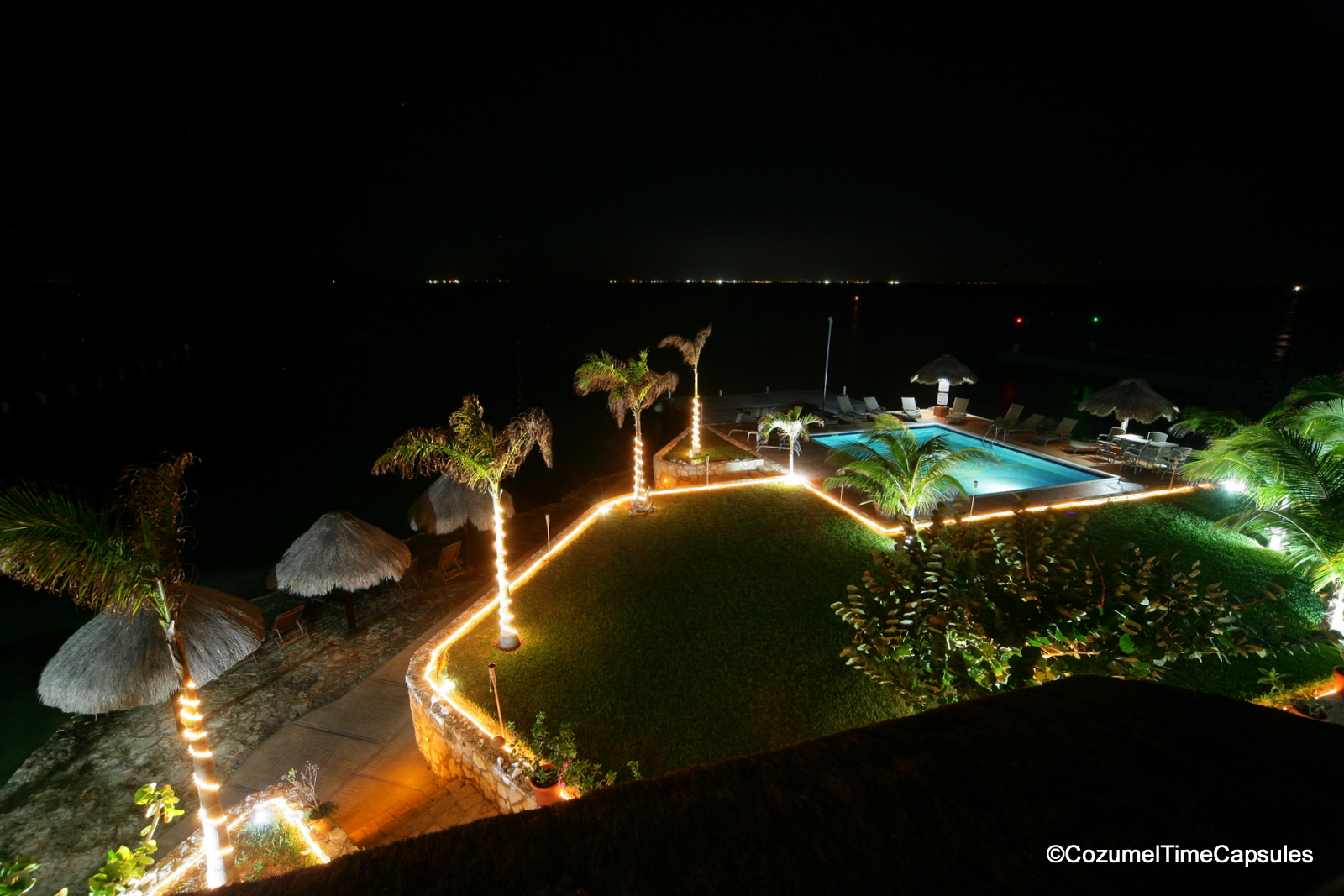

These were shot a few trips ago & are all with natural light & NO tripod. I used balcony railings or table tops to support the camera & most likely P mode + EC as necessary. The shot of the ship is hand held. This is from the 1Ds2, ISO 800, f8.0 & 5 seconds. The lights in the distance are Playa Del Carmen which is 12 miles away.
Also 1Ds2, ISO 1000, f4 (24-105 IS lens & IS on) at 1/4 sec.
And this is from my first DSLR the 20D ISO 400, f7.1 and 1/16 sec using the kit lens and the camera held tightly on the railing.
Just remember that if an image is too dark it's underexposed & will need either a longer shutter opening, a wider aperture opening or maybe some of both but you may also be able to raise the ISO but as you do you introduce noise. Unles you're shooting things that move keep the ISO as low as you can & use longer shutter speeds, BUT if there's movement you need the faster shutter speed & are basically forced to up the ISO as necessary or until it's all in.
