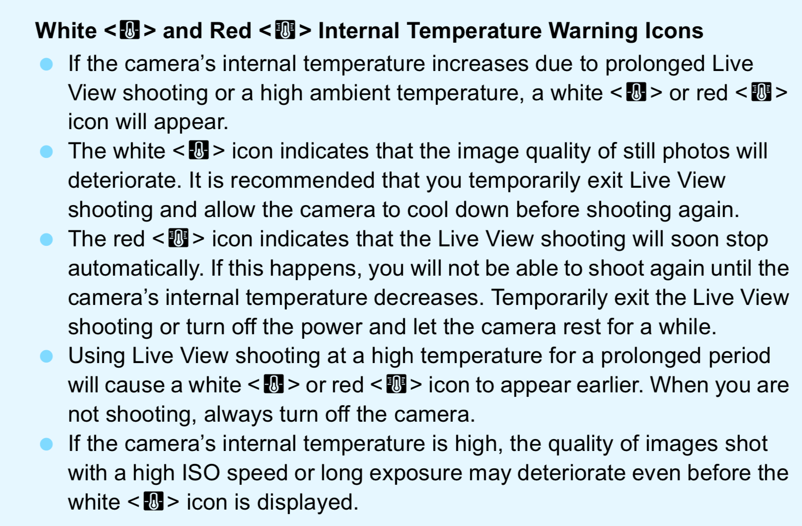

It sounds like it could be overheating.  There are warning icons that appear on the LCD when a camera begins to overheat.  Keep an eye out for them.

Sounds like overheating.  If this is the case, then there should be a warning icon that warns of overheating.
All Canon bodies display the red icon.  The white icon is used on the advanced bodes.
