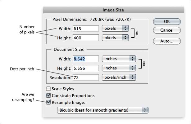

This is the pixel resolution size. It has nothing to do with dpi. Here is where folks go wrong.
This is the Image Size menu in PS.
The Resample checkbox changes how many pixels fit into a linear inch, actually PPI. If you turn off resample an image, the only way to change the image’s size would be to enlarge or reduce its pixels for printing.
If a person unchecks the Resample Image box, changing the Resolution box would alter the image’s physical size when printed, but not its number of pixels or in other words the size on a monitor. When it is printed, the image would appear larger or smaller. But on a monitor, it would be the same size also when you email it to whomever.
Resample is the key word here. You say it must be 1920 PPI, OK, whatever. The top menu 'Pixel Dimensions' and 'Document Size' are totally different. The top one tells you the image size and the bottom tells you what it would be when "printed".
Whenever an image file is created with PPI that differ from the dimensions of the original, pixels must be added or removed to produce the final pixel dimensions for the new image. This is a destructive process. Make sure you save the original in a safe place.
For instance, a 1900 x 1200 pixel image that is viewed/printed at 8" x 10" would be 190dpi. Whereas, if it was printed at 16" x 20 ", it would be 95dpi. DPI only matters if you are going to print something out
Homework;
Open up an image in PS at 72 DPI. Then in the image size box, change the DPI to 300. Now type the original pixel size back in. You will see that the image does not change in size or quality at all, just the rulers. This is because you've changed the amount of pixels it will print per square inch, not the amount of pixels in the digital image. But only if "resample" is not checked.
If it does resample going to 300 DPI, will add pixels. Resampling back to 72 DPI, will throw out pixels. This is destructive so make sure you try it on a copy of the original.
