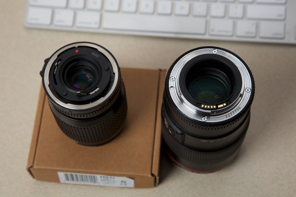

I am a bit suspicious that this may be for a non-EOS film camera (i.e. Canon "FD" mount lens). I did some searching for this lens, and every hit I can find for Canon mount is for Canon "FD" mount.
Here's a photo I took of two lenses. The one on the left is an "FD" mount lens for Canon film camera (pre EOS film camera). The one on the right is an EOS mount lens.
Notice the EOS mount (on the right) has several electronic contacts -- these communicate with the camera body. The lens on the left (the FD mount lens) has no electronic contacts, but does have a few metal tabs which the body can use to mechanically control the aperture or detect when the lens is set to manual vs. auto-aperture.
Incidentally, the lens on the right happens to be the Canon EF 100mm f/2.8L IS USM Macro. (If anyone is curious, the lens on the left is a Canon FD 35-105mm f/3.5-4.5)
If you look at the back of your lens and do not see the electronic contacts, but instead see those metal tabs, then you have an FD mount lens... not an EOS mount lens.
