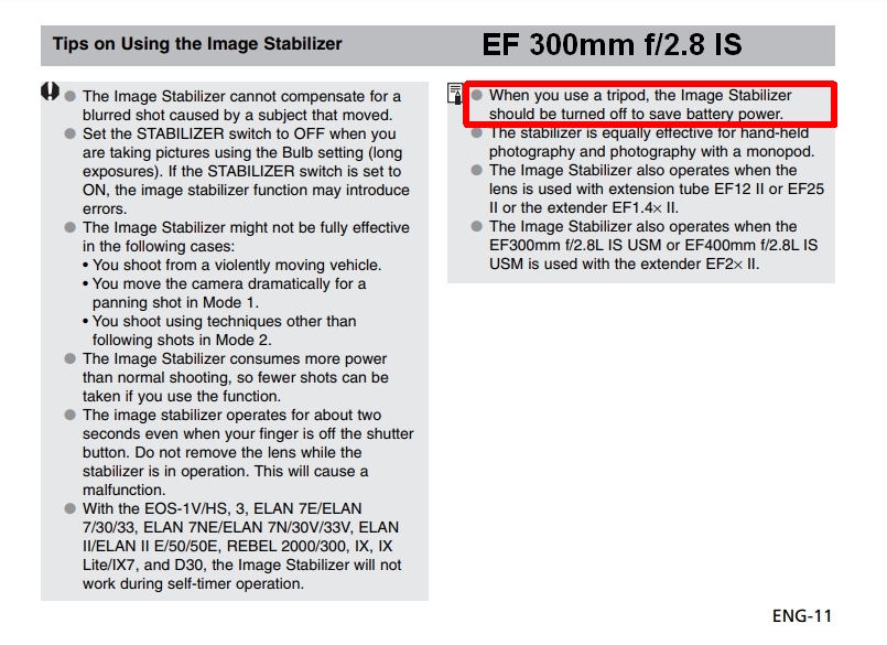

300mm f4 IS.jpg The EF 300mm f/2.8 IS from 1999 seems to imply you only need to turn off the IS if you want to conserve battery power.300mm f2.8 IS.jpg
The EF 300mm f/2.8 IS II from 2011 says it may be better to turn off the IS when using a tripod, but it depends on the tripod and the shooting conditions
